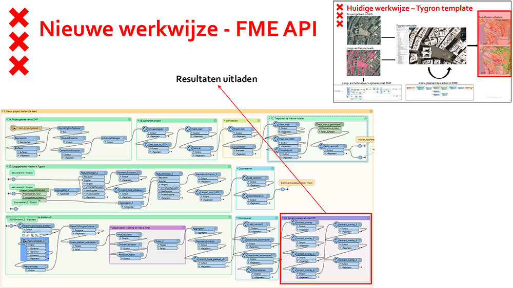

Tygron is used for large-scale area developments where design freedom and impact are significant. There was a need to automate the manual loading, unloading, and conversion of data, which was quite error-prone.
The consultants found the solution in an FME script that automates the entire workflow. “The template handles starting Tygron, calculating within the platform, and unloading all the Tygron maps we want to use all at once,” explains Clara Keuken. Input is minimal: only the project area, a password, and the storage location. The result is radically faster processing. The advantage of the new, fully automated approach is clear: “One click of a button and you can get coffee or check your email,” says Keuken. Then, with a laugh: “But I’d rather go get coffee.”

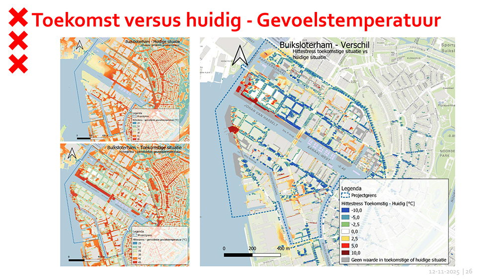

In Buiksloterham, they demonstrate the benefits of this. A former industrial estate is being transformed into a residential and commercial area. The current situation has virtually no cool spots. In the new situation, additional trees will be planted, making coolness available within 300 meters of almost the entire area. Difference maps mercilessly reveal the last remaining warm spots, for example, near the ferry landing. “A lot of people stay there during the day,” says Remijn, “so it’s good that we now have that in view.”
