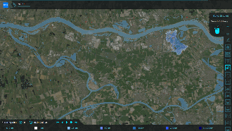

Flooding progress created with new Tygron GIF exporter

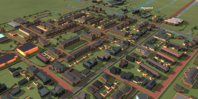

3D BAG data in 3D world and part of the flooding surface model

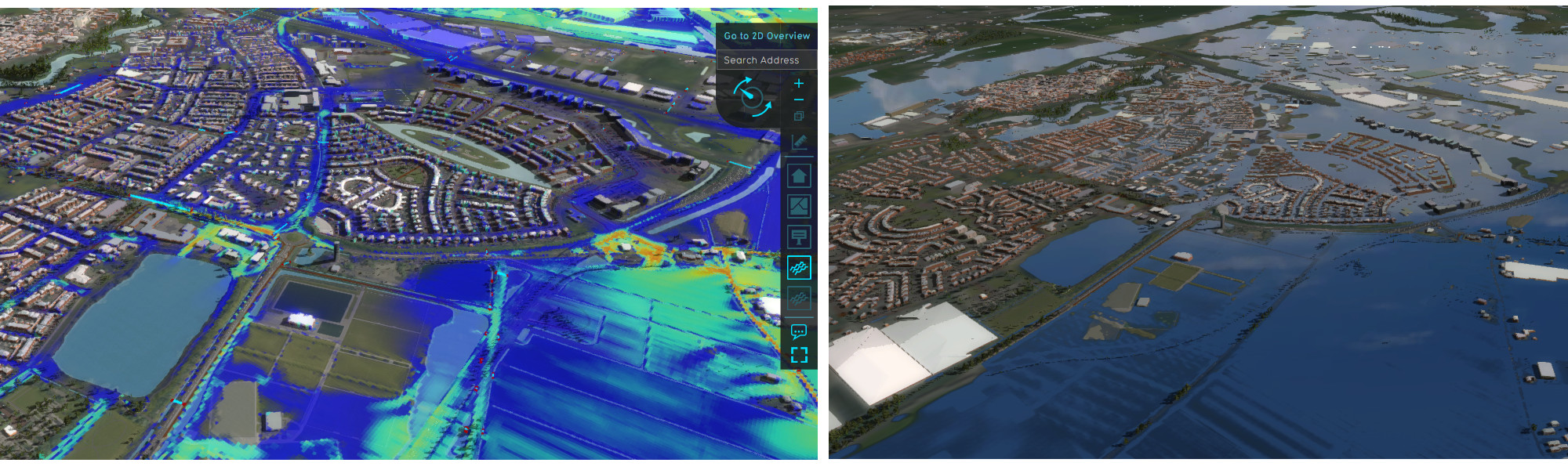

3D World based on a combination of 3D BAG, BGT, AHN, BRP, Top10NL, CBS, Risk Map is flooded.

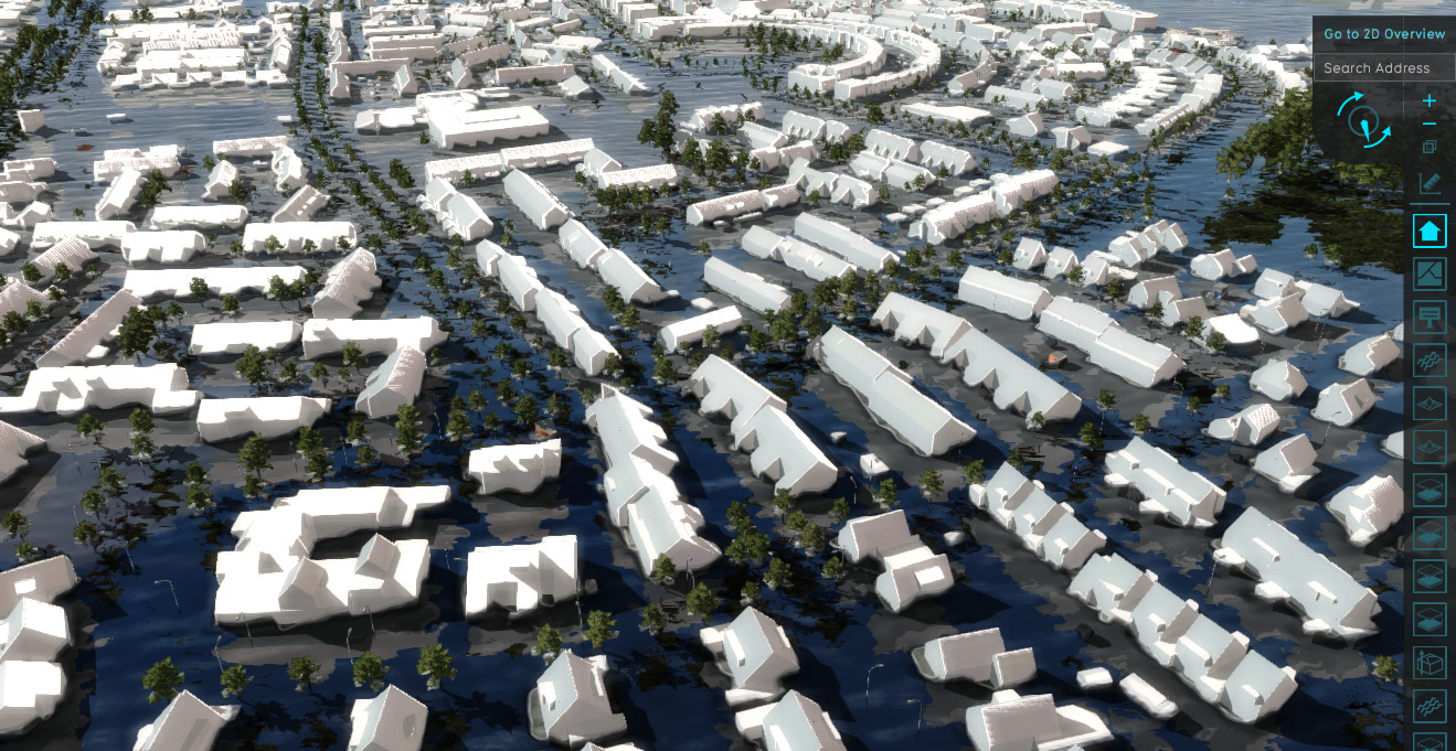

This part was also calculated at a higher 0.5m resolution

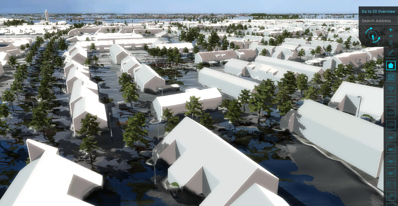

Approx 3 meter (out of 4 max here) flooding shows only upper levels & roofs remain visible

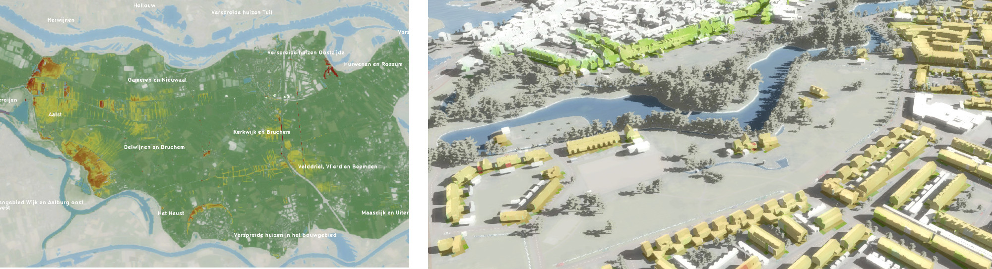

Using these new features we were able to properly calculate the flooding of the Bommelerwaard at 1x1m resolution and calculate the amount of fatalities using the SSM2017 method inside the Tygron Platform. We ended up with almost identical results compared to earlier studies done by the Delft University. Which is to be expected for a flat rural area, we also did some experiments in urban areas and there you need small cells for the water to flow around the buildings, trees and infrastructure.

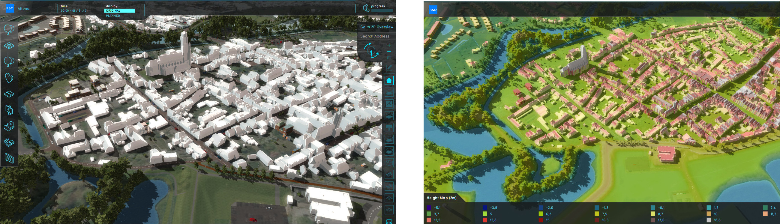

Mortality function based on SSM2017 and possible fatalities per house
