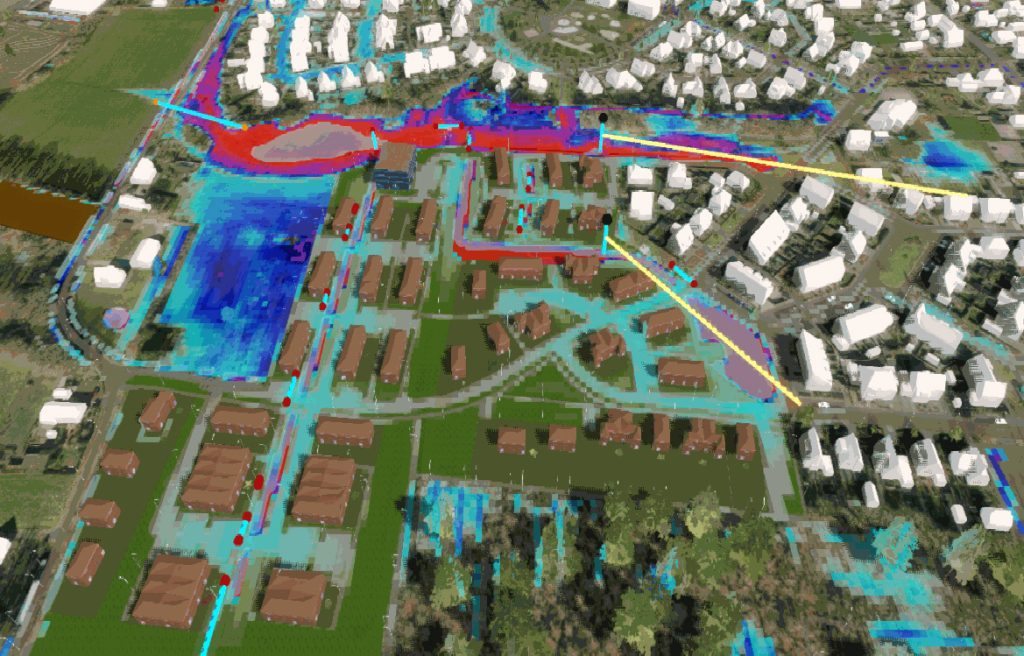

Keizer shows how data from existing infrastructure, such as roads and waterways, is combined with project data from CAD design files (spatial plans, preliminary designs, and final designs). This allows both a 2D and 3D visualization to be created for further analyses. For example, converted elevation data into a new ground surface model for waterlogging analyses, or converted 3D designs for heat stress calculations. Importantly, the process is iterative and supports both policy makers and designers: "We are noticing that there is also more and more attention from the design side, from project managers, to apply this themselves in projects," says Keizer.
