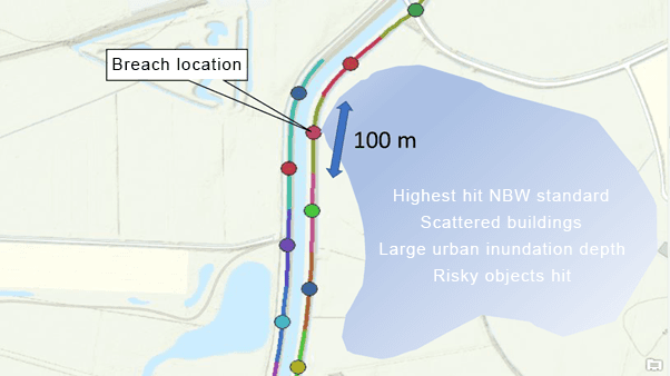

The tooling consists of a script that prepares the projects and automatically breaches the flood defense every 100 meters. For each breach, the following is calculated and exported:
  • How much water is in which location.
  • To what extent that overlaps with the water board's standards map.
  • Which risk objects in the area are affected, broken down into different categories.
The tooling is reusable for other water boards. An example of its use is also available in our Python SDK. The user can set the guiding principles under which calculations must be made, and the tooling is then fully self-operable.
