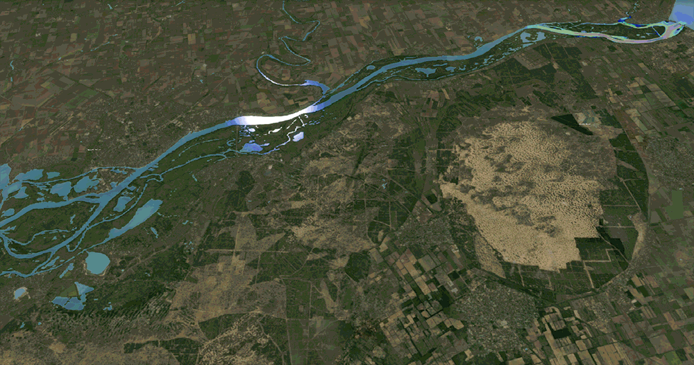

June 9 2023:
The model was updated with a 20-day predictive time frame, providing very highly detailed information about the situation in the affected areas over the coming days. While the flood peak had subsided, the area would remain flooded, although the water levels would gradually recede. The simulation provided insights into water depths over time.
Improvements:
smoother breach growth from 200m to 550m wide.
minor improvements to the legend
improved infiltration in the 20-day run, based on land type, with 50cm storage in the soil for the three-week period. On average, the drying starts after six to seven days.

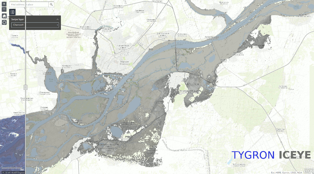

June 11 2023:
The next steps were to gradually work towards more insights and validating the approach and model. More validation material was processed, such as satellite imagery and photos of specific locations. The results were made available in a swipe viewer:
https://tygron.maps.arcgis.com/apps/webappviewer/index.html?id=4d454f03a32243b8bd3e6c9093c6fc99
