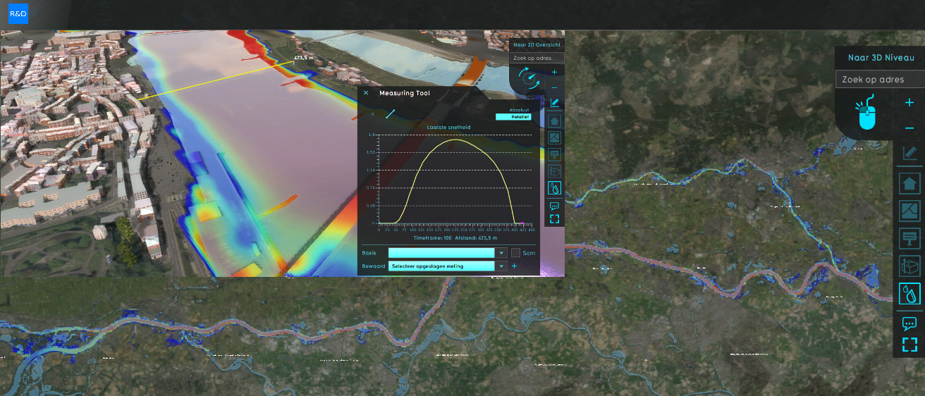

The major river experiment worked, but also resulted in many new challenges. Water flows through the rivers, but we did not jet include all the detail about the river weirs in the entire Netherlands. But also for example the amount of zoom levels in the Tygron client software was inadequate and the memory requirements for the client application (not server cloud) are very high.
Waal river speed with detailed inset from same project
